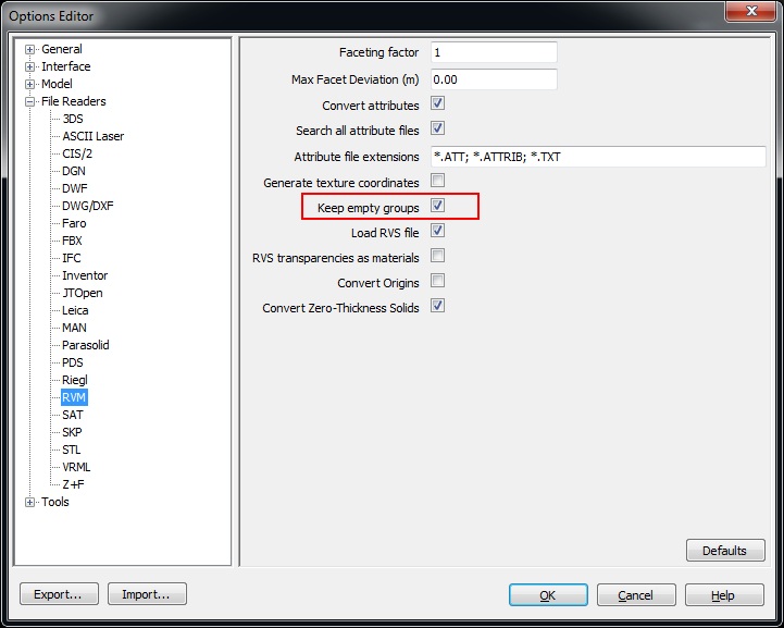

Dear All,
I am just starting using autodesk naviswork manage 2010.
Why when I read *.rvm file the hierarchy shown just only the site not the complete same as in PDMS?? How to solve that??
Thanks alot

Venkata Rao Peta
over 11 years ago
Utilities-->Export-->Dump Attributes you can use.
In Navies you can load this file.
