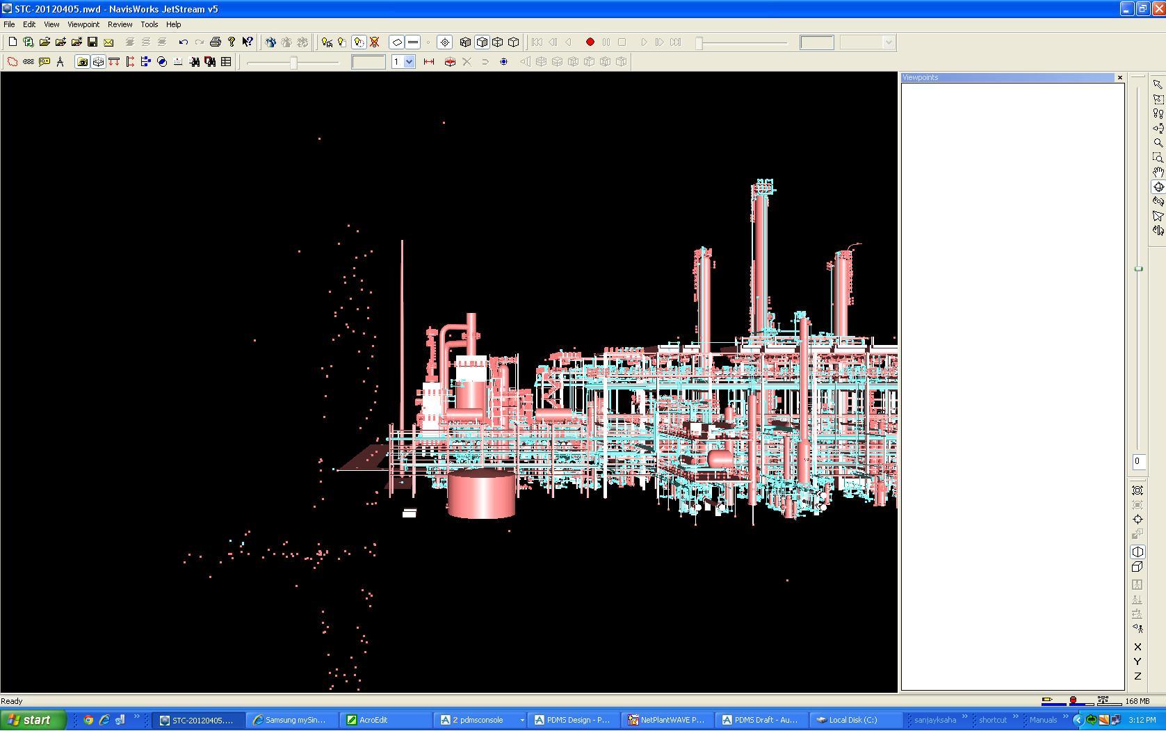

Naviswork Review

    try to pick the points in navisworks and check what that element in PDMS design. Maybe it is an equi premitive that had no/zero dimension (e.g. dia of cylinder).
