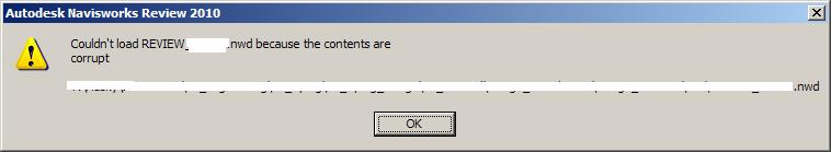

However, now I am running into a problem, the NWF file works fine still but the overall NWD file saved from the NWF session doesn't work anymore. Autodesk Navisworks Review 2010 error message: "Couldn't load ......nwd because the contents are corrupt."
Does anyone there experience this problem before? How did you fix it?

[COLOR=#333333]when i was opening the RVM file in navis simulate, it saying that content is corrupt.[/COLOR]
[COLOR=#333333]could you please help any one it is very urgent!! PDMS 12.1 SP2 VERSION!![/COLOR]
Try to create rvm site by site of your project and check o each time wether it can be read. As usual it is caused by some factors too long attributes or db errors.
Thanks for your reply, Yes i created the individual site, all sites are open without any error.
We didn't understand What could be the problem beyond it!!
