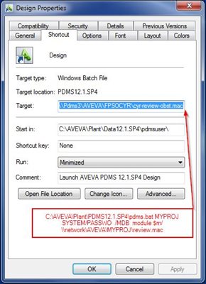

Could you share any good example of batch file, that create review 3D model during each night from Design?
Thank you very much.

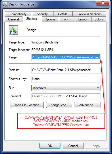

there nothing to write inside bat file.
It is the same bat as for normal projects start. the only difference is shortcut has some parameters and as one of them is a macro to run. How ot use this shortcut is writen in that doc
Use scheduler built-in on server OS

I've written the part of Review file creation, and it works well, but only when i push it into Commant Line. :-(
I have 2 more detailed questions:
1) Could you show me the example from real project - how it should be written in bat-file?
2) Could you show me the example of scheduling it in Windows?
