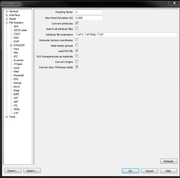

Hello Forum,
the Export works very well but i have some Problems with Imported STEP Files.
When i importing step files, many genpri elements will be created. When i open the RVM File in Navisworks, Navisworks crashed.
Is there a Workaround to fix this Problem?
me_hungry
over 10 years ago
When U use MEI it is desirable to replace genpri to boxes or cylinders.
