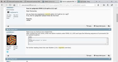

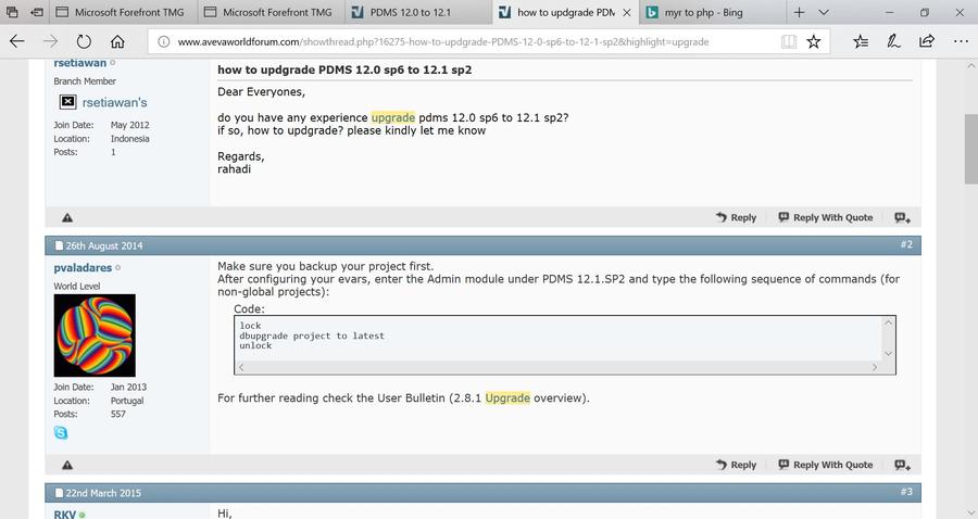

    I think you will use ADMIN to upgrade from 12.0 to 12.1 by using command
    DBUP PROJECT TO LATEST
    Please read User Bulletin for more details.
  • Azmatulla Mirza Baig
    Azmatulla Mirza Baig over 6 years ago
    There is a single upgrade command  in Admin which will work on a DB or the whole project.
    If successful, the upgrade number for the DB will be updated.
    The syntax is:
