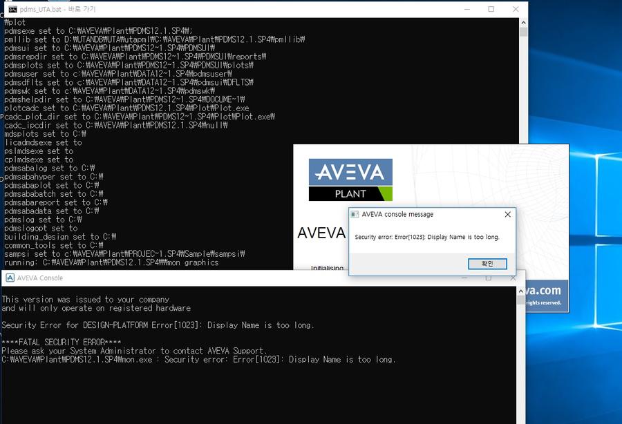

[QUOTE=EngineeringCC;119694]When I Open PDMS Module, The Security Error 1023 occurs.
c:\AVEVA\Plant\PDMS12.1.SP4\mon.exe : Security error: Error[1023]: Display name is too long.
Please help me.
[ATTACH=CONFIG]12751[/ATTACH]

JongHyun Jung
over 3 years ago
Thank you everybody.
Uncheck Internet protocol version 6(TCP/IPv6) at ethernet property solve this problem
