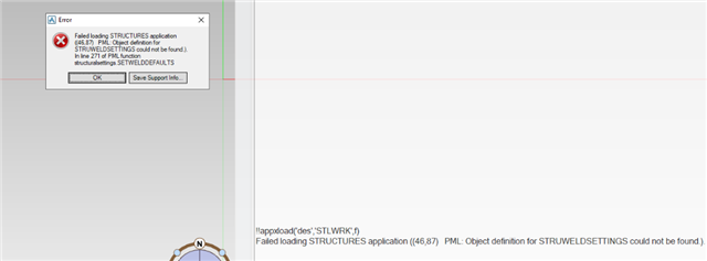

Dear Experts
anyone please help me with this error ??
Dear Experts
Latest Fixes of E3D 3.1 have a new tool for structural/panel welding.
But as far as I know it requires the latest ACP Project too.?
Which version have you installed
3.1.6.1 is the using version.This do not have issue with any other user but only for a user
Try deleting C:\Users\username\AppData\Local\Aveva\AVEVA E3D Design\3.1 once exited from E3D
Thank you
The problem is with improper installation of FIX
Thank you
