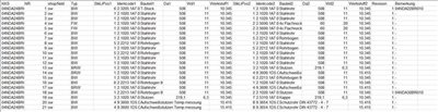

weld & mat file,weld & mat file

    Wht dont you customize report in report designer in E3D. all attributes can be easily called and reported.

    but how do you call the attributes of the next prev element wich are connected with a weld?
    for example, elbow and tubi

    For example DTXR of PREV or MTXX of NEXT

    but when you have elbo-tubi-elbo-tubi-elbo, like this you are asking for the attributes of the prev or next elbo...no for the piece of pipe...for example

    Then could be something like IFTRUE(LTLE OF PREV EQ 0, DTXR of PREV, DTXR OF LSTU OF PREV)
