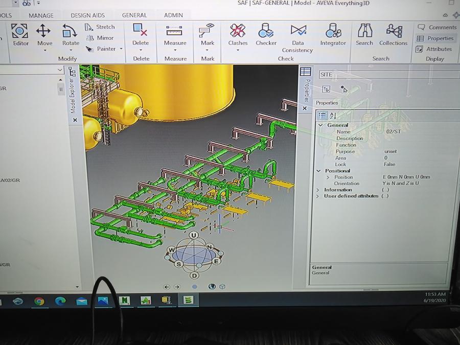

    You need to upgrade the complete project, not possible with commands.
  • Alan Nito
    Alan Nito over 5 years ago
    How to upgrade? do you have any idea to upgrade it.?
    I did it before is in the admin but i forgot it.
    Can you help me Mr. Deva.
    Many thanks
  • Alan Nito
    You can do in E3D admin module
    lock the project
    in command DBUP TO LATEST
  • Alan Nito
    Thank you very much Mr. Hilman
