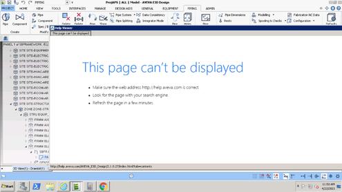

    You probably have some kind of internet restrictions.
    Check your Company Policy
    As a workaround, you can download the Help On-Line Documentation from Aveva, save it somewhere and modify the custom-evars file as here below (it is just an example):
    set AVEVA_DESIGN_HELP_HOST=file://D:\AVEVA\E3D3.1\WebHelp\

    Thanks for the reply.
    local help files are working fine.
    Thanks

    Hi,
    In which file the website (http://help.aveva.com/AVEVA_Everything3D/2.1.0.24/index.html) is mentioned?
    can we change the site name as (https://help.aveva.com/AVEVA_Everything3D/2.1.0.24/index.html) since it is opening in internet explorer.
    Could you please let us know.
    looking forward to a positive reply.
    Thanks in advance.

    Try with:
    set AVEVA_DESIGN_HELP_HOST=help.aveva.com/.../index.html
