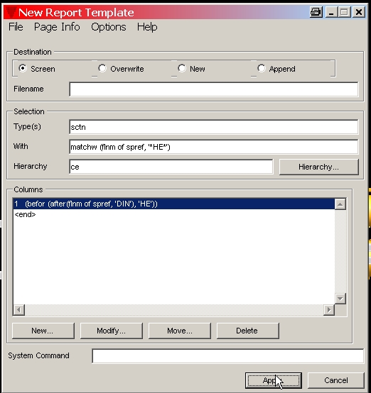

    Is there a way to increase the number of characters in WITH CONDITION ?
  • LEANDRO
    LEANDRO over 14 years ago
    But how to select one part of the text between to symbol.
    For example i would select the spref of 5 ATTA in a Branch.
    ATTA SPREF /aaaa/bbbbb:nn
    i would in my report bbbbb
    When I create my report i set
    TYPE(s) : ATTA
    WITH : (AFTER(BRANCH,':nn') $*) AND (BEFORE(BRANCH,'/aaaa') $*)
    Hierarchy : BRANCH
    Columns : I create a SPREf
    It's' corrected?I do not succeed to execute it
    Thanks in advance
