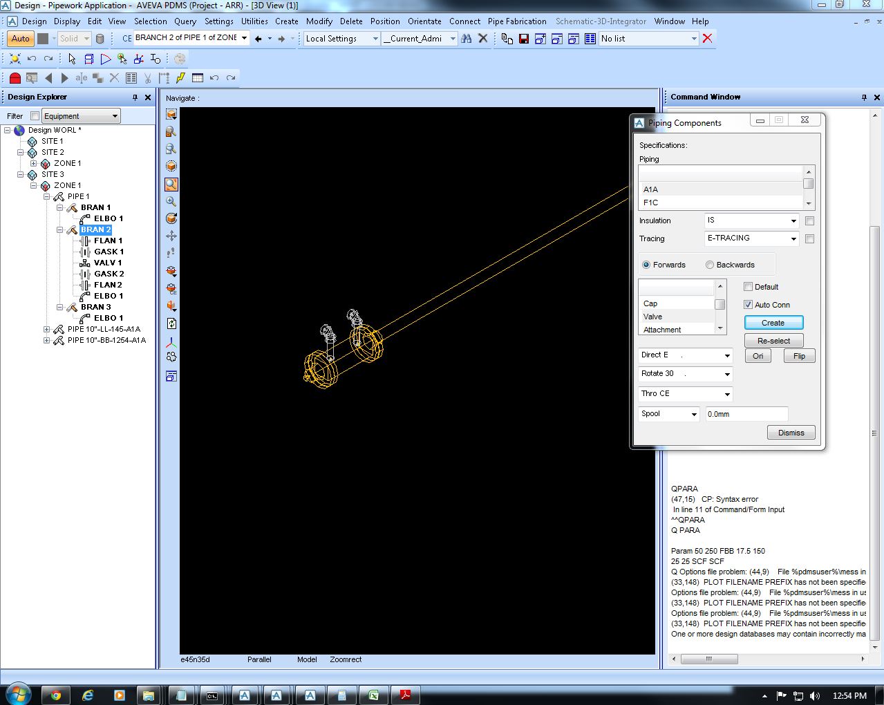

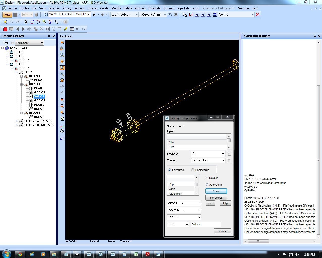

There is a bit of mess....
Your 3D element is a VALV, with a TEE icon and a PCOM (or SHU) Base skey.
Are you the PDMS Administrator of your company?
Have you ever attended a Piping Catalogue & Specification training course?

Hi all,
Could you please reply any body.
Thanks in advance..
Rajendhar
Corrado Galluzzi
over 10 years ago
I would try using II** as Base Skey......
