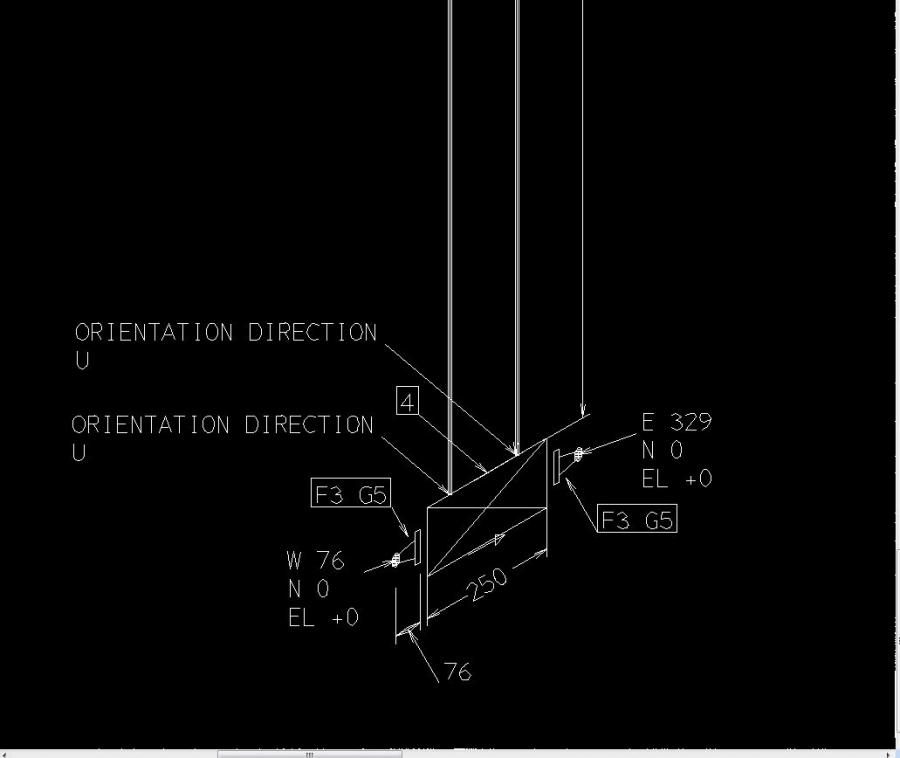

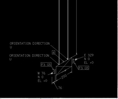

In Paragon, you need to set PSKEY attribute of P-Points to 'Butt Weld'.
RAJENDHAR RAMENDLA
over 10 years ago
RAJENDHAR RAMENDLA
over 10 years ago
Hi Corrado,
Thanks for you are kind help.
Yes it is working fine.
Thanks
Rajendhar
