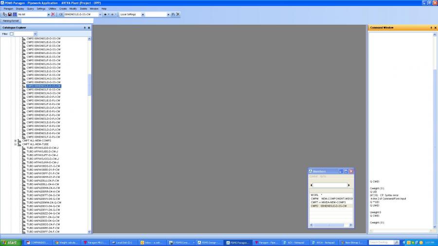

    i need material list for pdms 11.6.
    in pdms 12.0  when i give command
    q cmpref  i got the attribute but when i give command
    q cwei and q nwei i got 0.
    i check the q att of cmpref i got
    Bflex -100000
    i have doubt about this attribute.
    please help me

  • Aditya
    Aditya over 10 years ago
    Thanks for your quick reply
    ON CHECKING CWEI OF CMPD I GOT 0.
    ON CHECKING CWEI OF TUBD I GOT DO NOT HAVE ATTBUTE.
    ON CHECKING OF Q ATT OF CMPD
    I GOT Bflex -1000000
    i have doubt on this
    what is function of Bflex ?
    Are this Bflex value is correct?
    Please answer give soon.
    i am waiting for your response.
