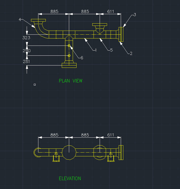

pipe fabrication sketch with components

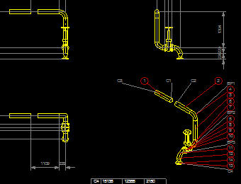

I think that's because valves have Shop attribute set to Fals (erection material).
Usually pipe sketches (spool drawings) are generated for pre-fabrication purposes (Shop attribute set to True)
