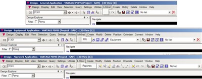

I'm a new user of PML and download the file in this thread and put in even directories , but nothing happens. My PDMS version is 11.6 SP4. You can help me ??
