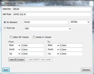

    You can use Add ce, Add ce members and also through add selection
    If you want some bran to be added with Ispec /k For eg.
    In this case
