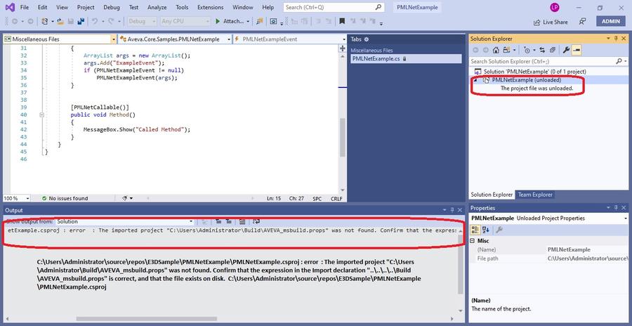

Opening Project File in Visual Studio 2019 error from E3D 3.1 samples
Sri
over 5 years ago
Sri
over 5 years ago

Sri
over 5 years ago
Yes
I given complete access by removing the
Read Only
[/U] Option
I see its also looking for another file called
\AVEVA_msbuild.props
which is unavailable in my computer.
Im not sure how to address this ??
me_hungry
over 5 years ago
Just remove this line from
PMLNetExample.csproj
