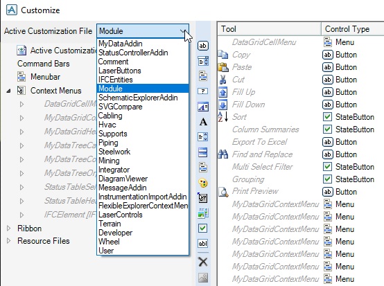

Custom Addins not shown in Active Customization File list

Atish naresh parkar
over 5 years ago
change %PMLLIB% to complete path C:\Program Files (x86)\AVEVA\Everything3D2.10\PMLLIB\
[COLOR=#0000ff]VAL_pmllib\Menu
you can locate files on other network drive as well [/COLOR]
Viet Anh Le
over 4 years ago
Thanks! I also tried it before but it didn't work
Christian
over 4 years ago
why do you have so many blanks everywhere
DesignGeneralAddins .uic
%PMLLIB%\VAL_pmlli b\Menu
DesignGeneralAddi ns
etc
i am confused. if this is really the copy paste from the file you should check your blanks first
