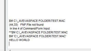

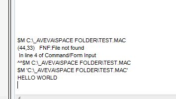

I have some macro files under a folder with space in the folder name and I found that if I use $M/

cutesmile,
You saved my day and thanks a lot.
[QUOTE=cutesmile;108688]you could try something like $M '
