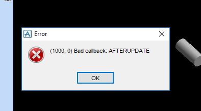

• Hello YangBui,
    I'm assuming you've attached an event to your Grid, something like this:
    !grid.addEventHandler('AfterCellUpdate', !this, 'AfterUpdate')
    Where !grid is a NetGridControl object.
    The associated method (AfterUpdate in my example) must be declared in a certain way in terms of arguments.
    Example:
    define method .AfterUpdate(!args is ARRAY)
    endmethod
    You have the list of the available NetGridControl events here:
    https://help.aveva.com/AVEVA_Everything3D/2.1.0.27/wwhelp/wwhimpl/js/html/wwhelp.htm#href=NCUG/NCUG6.08.06.html
    (Sometimes there are mistakes in this documentation concerning the required arguments, as for the AfterCellUpdate of my example below.)

    Thank L, I solved this error with remove the line represented for event 'AfterCellUpdate', your way is also another solution, may I will try it later.
  • (1000, 0) Bad callback: REFRESH
    Im getting this error but why not sure
