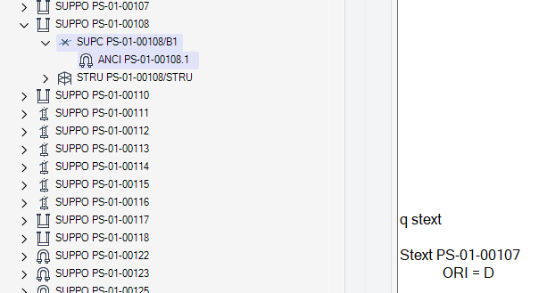

Hi all,
I am facing issue while replacing stext at ANCI level users copied supports & rename all
but stext not change so I want to replace stext with name of suppo without changing ori in stext.
How we can sort it out.

Use the collection and try someting like this "!!ce.stext = !!ce.own.own.namn"
updating like this
Stext PS-01-0017
but want like this
Stext PS-01-00110
ORI = D
ori should not change
