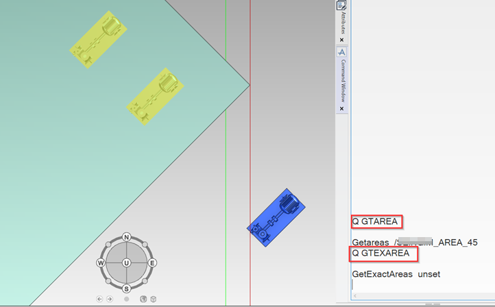

1. What is the difference between GTEXAREAS and GTAREAS? The manual's descriptions are not clear to me.

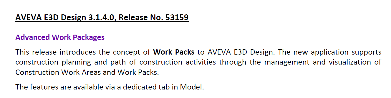

3. In a nutshell, what are Work Packs used for?
1)
Look at the picture here above.
The green transparent box is the area. It is rotated by 45 degrees.
The blue pump is the current element.
The red line is one of the edges of the area's "bounding box" that is orientated and aligned to the World North.
So GTAREA returnes a value as the pump is within the area's bounding box limits.
GTEXAREA is unset becuse the pump is outside the "exact" area.
So...
Hope this make sense

This comes from the E3D 3.1.4 Release Letter ;-)
