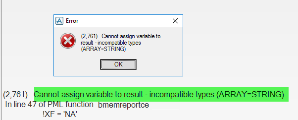

Dear expert,
how can I assign 'NA' to the VAR !XF ?
Appreciate any help

Hi,
The command eval dtxr for all from !bmem returns you an Array with the dtxr value of each element included in your Array !bmem.
In your Handle, you give it a simple String instead, which doesn't work.
The most suitable would be to loop through !bmem and handle your error in your loop.
Something like this:
!dtxrs = ARRAY() Do !member values !bmem !dtxr = DTXR of $!member HANDLE ... !dtxr = 'NA' ENDHANDLE !dtxrs.append(!dtxr) Enddo
