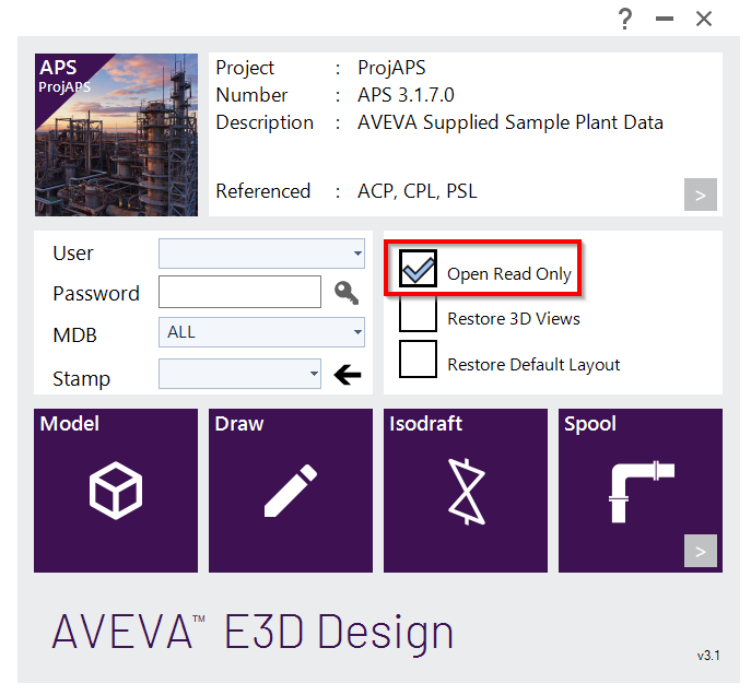

What about using DAC?
Or you can remove a user from all the Teams.
She/He could enter in Read Only mode:
About locking a database, you could assign it to an empty (with no users) Team?
Intention is to avoid that particular user login some time
Lock the DB and delete unlocked DB's
Ok. So you could remove the user from all the Teams, couldn't you?
its implemented for now but Im checking the disable options
