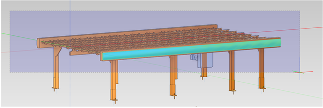

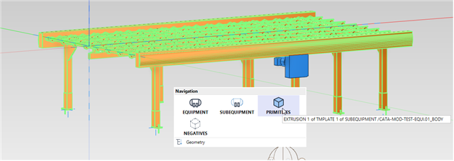

Hi,
1. Is activating this selection mode possible in PML
2. Then are the selected items when doing click and drag the left mouse button to select elements able to collect or save in an array in PML?
Cheers,
Edgar
Hi,
Cheers,
Edgar
1. Do not know
2.
!sel = object selection() !sel.getcurrent() q var !sel.getselection()
Thanks to you, half of my problem is now resolved!!!
