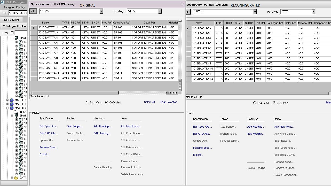

Reconfiguration of specification
Sebastian Loyola
Sebastian Loyola over 13 years ago
  • Sebastian Loyola
  • Vohra Aslam M
    Vohra Aslam M over 13 years ago
    Have you reconfing using same ref no method (command)??
  • Sebastian Loyola
    I used
    from files /a /b
    to db master/A
    reconfigure
    i dont want the spwl in the same database number. the situation is that the reference that are lost are the reference that are only in the same database
  • Vohra Aslam M
    Same reference no is possible only, if destination and source db no is same.
