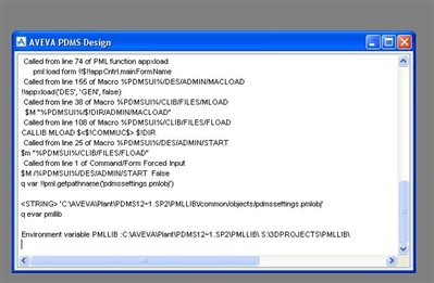

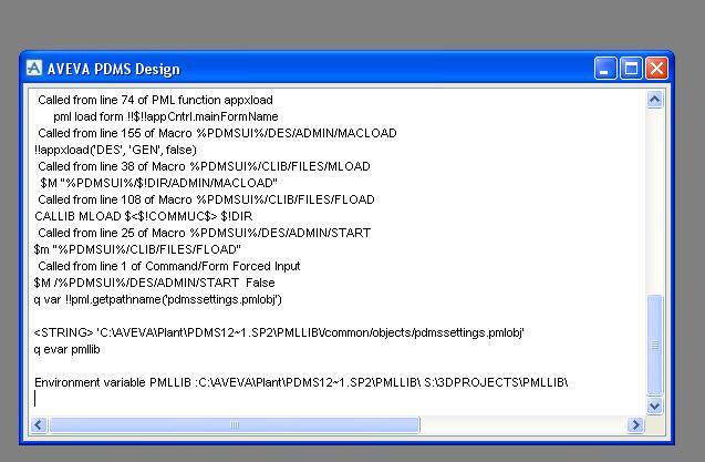

    in white window query
    q var !!pml.getpathname('pdmssettings.pmlobj')
    it should be located under PMLLIB\common\objects
    and
    q evar pmllib
    and just in case do PML REHASH ALL
    I am still guessing that you lost original PMLLIB somewhow
  • Admin
    Admin over 12 years ago
    post results here

  • Parag S Newe
    Parag S Newe over 12 years ago
  • Thomas Back
    Thomas Back over 12 years ago
    Use semicolon instead of space between the different paths.
    set PMLLIB=%pdmsexe%pmllib[COLOR="#FF0000"];[/COLOR]S:\...
  • Parag S Newe
    Hello TBack,
    Sorry for late reply.
    No use. still showing same error.
    for time being, i have placed customize PMLLIB below default path of PMLLIB. :(
