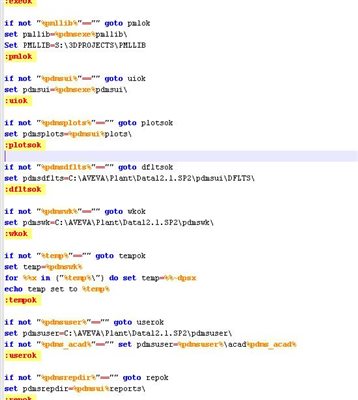

    remove nuclear database from your databses

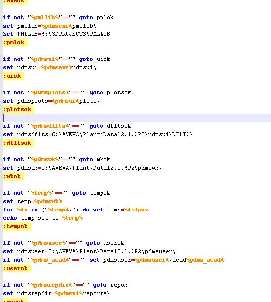

  • mayuresh chaturya
    mayuresh chaturya over 12 years ago
    Hi paragnewe,
    To define another path for pmllib directory,
    Define it separate (Don't include in default path).
    Use below syntax at end on evars.bat
    Set PMLLIB=S:\3DPROJECTS\PMLLIB
    It will work... I tried...
  • Admin
    Admin over 12 years ago
    when assigning a new PMLLIb do not forget that original one also must remain. otherwise PDMS will lose all its original functions

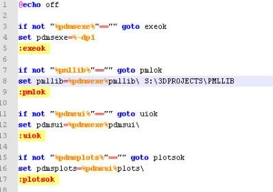

  • Parag S Newe
    Parag S Newe over 12 years ago
    Chaturya,
    Thanks for your reply.
    But if I assign new path in new Line for PMLLIB as you shown, then is it OVERRIDE on earlier Dflt path?
  • mayuresh chaturya
    Whats the matter with that?
    Even you define new path, it will execute files from both locations(Paths).
