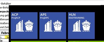

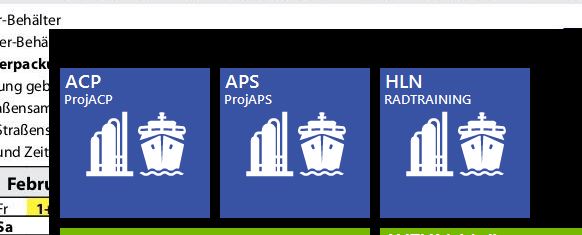

Hai Long
over 5 years ago
Nguyễn Hải Đăng
over 5 years ago

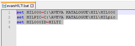

Hi
Poloblum
Try to remove all space in you folder name. And correct all path in evarsGFP.bat and [COLOR=#333333]
evarsHILTI.bat
[/COLOR]
Hai Long
over 5 years ago
