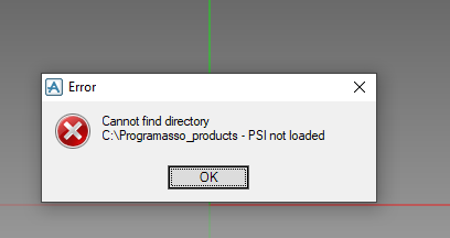

    In Sample Project I am able to run PSI but it's not working in my Created Project. I've created zone with Purpose PSI. Following error showing
    Corrado Galluzzi over 3 years ago in reply to Godwin Fernandes
    It doesn't find the installation directory.
    Make sure that when entering your project, environmental variables are correctly defined and the software has been correctly installed and configured.
    In my machine for example is here:  C:\AVEVA\E3D2.1\Everything3D2.10\asso_products\psi

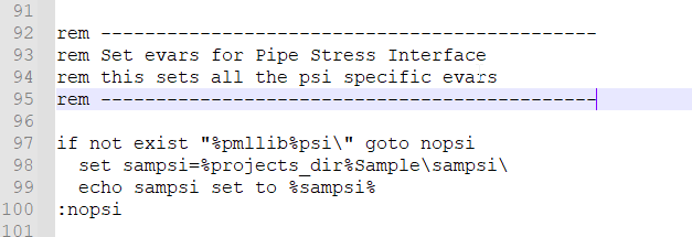

    Hi corrado,
    Yes,In my machine also PSI path is same, all file are available. If you don't mind can you show where we need to define PSI path in environmental variables and how?......
    And I'm wonder that why it's working on sample project not in created one.
     I've define XXXPSI folder location in environmental variables also. Then also it's showing same error.
