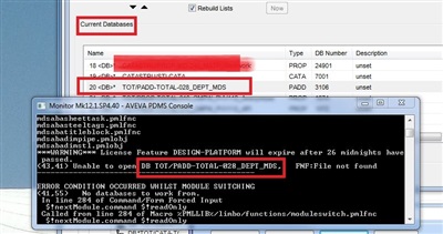

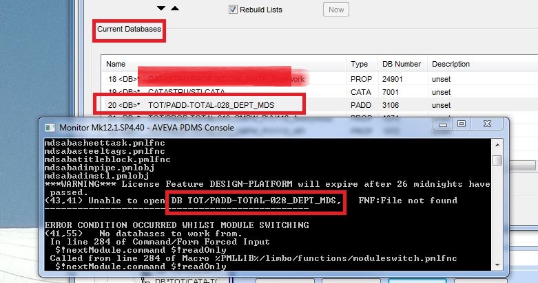

Error 43, 41 Unable to open DB
Usman Shehu Isa
Usman Shehu Isa over 5 years ago
  • Usman Shehu Isa
  • me_hungry
    me_hungry over 5 years ago
    I think you included this DB from other project and something happened with this db file(maybe reconfiguration).
    Check if you can see that project or try to exclude DB and re-include once again.
    PS:Before any changes make a backup :)
    PPS:You need admin password of external project to include DB
  • Usman Shehu Isa
    Thanks me_hungry...I excluded all the DBs...they were from an older project and not really necessary. :encouragement:
