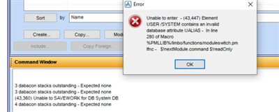

Unable to change System password

Repair System DB, May be it is corrupted

I already tried, but no luck....

The Alias can be set to a short name (up to ten characters), the value can be used in the revision blocks for diagrams and datasheets.
UNSET this attribute on USER/SYSTEM
Q Ualias
