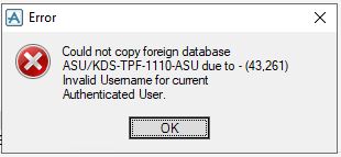

Does anybody know why i cannot copy foreign from project A (Old) to project B (New), it says Invalid Username for current Authenticated User. But when try open project A, the user & password are all ok.
Project A (Old) = Admin 1.5
Project B (New) = Admin 1.9
[ATTACH=CONFIG]12680[/ATTACH]
Thank you in advance
One Possible reason :-
Error shows Authentication.. Check Project NT Authentication ON/ OFF .
accordingly you may need to add username to Authentication user..
