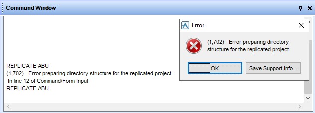

Make sure you have all the necessary folders and sub-folders.
My suggestion is to create a brand new project from scratch using the Project Wizard creation.
Then you delete the ABU000 folder content (sys, mis and com databases)
Then you replicate your original project.

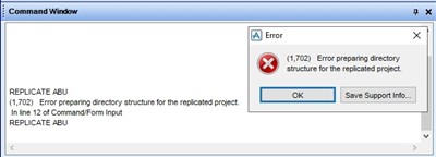

Thanks for your quick response. However, I tried what you suggested, but got the same error as I mentioned earlier.
Could I be missing any prerequisite steps other than what you suggested? I have created a fresh project multiple times, but still experiencing the error.
[QUOTE=ebonined;120162]Thanks for your quick response. However, I tried what you suggested, but got the same error as I mentioned earlier.
Thanks in advance
I finally figured it out, I had to create the new project with the exact directory in the original project. Thanks a lot for the assistance
