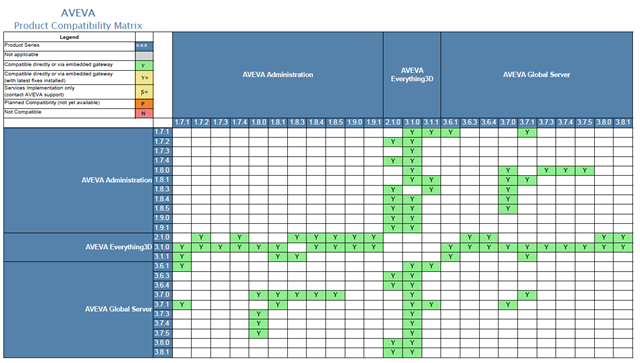

Hi, anyone can be suggest where I can generate AVEVA Product Compatibility Matrix report like below?
Thanks.
Thanks.

Look like function that uses to comparision for each product version doesn’t available.
Could you sugest which of Aveva Global version that compatible with;
AVEVA Everything3D 1.1.0.36
AVEVA Everything3D 3.1.4.0
AVEVA Administration 1.9.5.1
