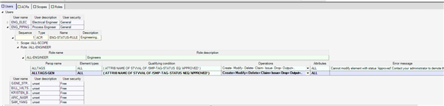

Now, I tried to change the ACR to have the same behavior for my Status Value
Here are the details of my rules (attached)
When tested in Engineering it does not work.
I changed my status value to 'APPROVED', However, I can still change values after
My rule must be wrong. Any idea?
