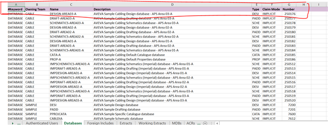

i am missing filename coloumn in the report!!, dont know where i am miising
It is not an issue.
The scope of exporting a project, is to then import it again to create a new project or to update/modify the source one.
Database filename it is not something you can specify/modify so it is not needed in the excel spreadsheet

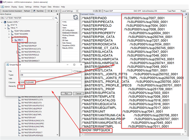

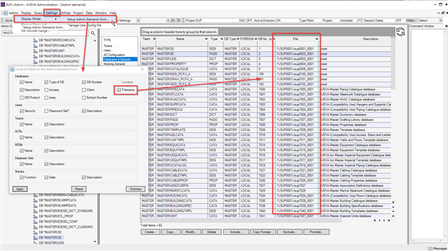

i have received one project where its been found dbnum is not same as file name ( dbnum 5467 & its filename 7658) , so i wanted to look in how many places it is coming, since i am assisting my colleague in a global project so we have many db's. ...again very true we cannot modify it, only identification is required in report or...i am finding ways how to report it out....like if i will ask q dbfile ( it will show the name of file)...so in the above context i was asking, or could you just guide me with any other method....thanks in advance
Here is one possibility....

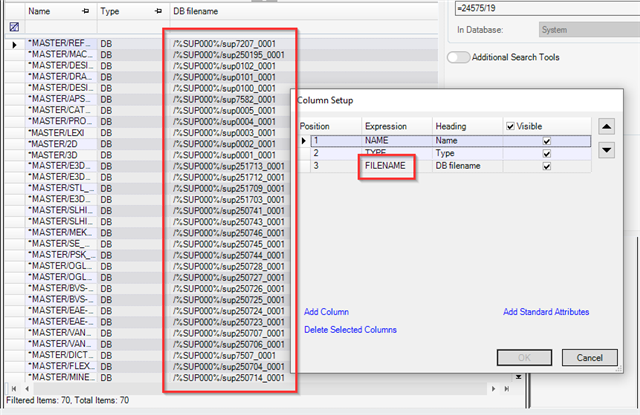

Another one...

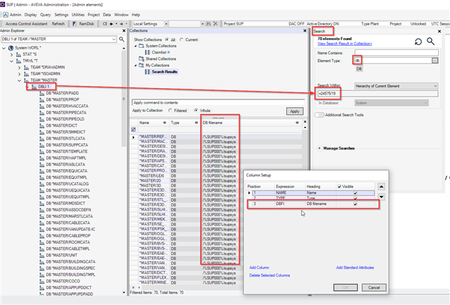

Third one....
I apologize....the second method...correct version:
