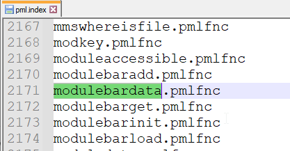

The problem is when I try to enter the Admin Module I get one error about "MODULEBARDATA" (see image)
I'm assuming that this is a problem with Administration 1.9 and AVEVA E3D Design 2.1.
