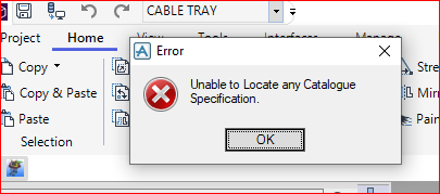

Dear Experts
I have reconfigured the data to a db and I see the all references are available with stex and purp is TRAY
Why still some error ?? like below
Dear Experts
Not sure this will help.....
Double check you have a Limbospec available
Default 250706 db should be available in MDB
