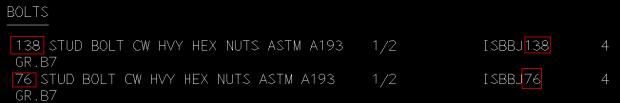

To Customize Part Number of Bolt

    i think you have this in your option file:
    Bolting  length itemcode APPEND
    this append the bolt length to the itemcode
    delete (or --) this line.

    thanks pitch, it seems i missed it when i ran through isodraft userguide :embaressed_smile:
