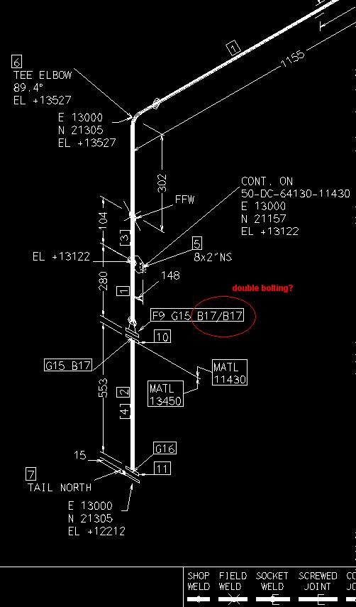

    Pls refer the snapshot. There is a double bolt indicated on isometric drawings.
    What is the possible cause and how do we rectify it?

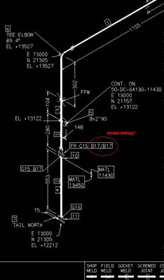

    Check item 10
    It looks like a flange but does not appear to be flagged as part of the joint
    Does the connection type start with F
  • Huynh Anh Tuan
    Huynh Anh Tuan over 14 years ago
    Hi xpdc75,
    These components are set to New Type Bolt. It doesn't depend on BotlTable at all. Each Bolt on the same flange-set can have different Lengths.
    So you can look at members of BTSE to check it.
