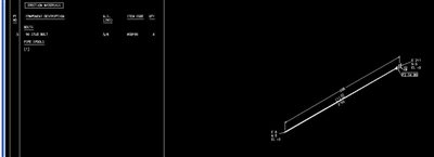

nut are not display in isometrics (urgent)

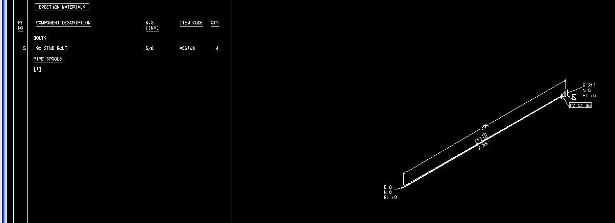

Hi
Are you using Old Bolting method?
Mr.PITCH explained well in one Thread about what are the limitation of Old Bolting method.
john pitchers
over 14 years ago
It is a common practice to ask for nuts to be supplied with bolts by including them in the bolt description.
That way they do not need to be included on the isometric, except in special cases where additional nuts are required.
vivek chudasama
over 14 years ago
yes Mr. basker I am using old bolting method. you have idea about that how to calculate the nut.
