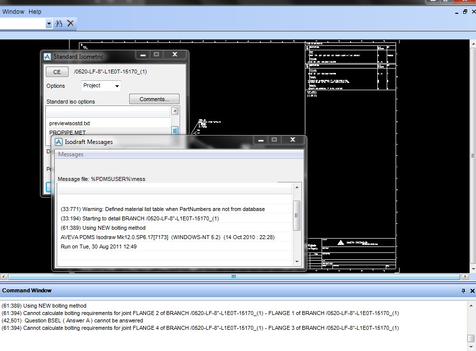

Bolting Problem with bolts spec

    That suggests that one of the components has BSEL set to 'A' in Design but no bolts in the spec have BSEL set to 'A'
    Check the component attributes

    components how flanges or valve dont have BSEL question
    i don't know what to do

    In DESIGN at the flange or valve
    Modify>>Attributes
    or
    Command line
    Q ATT
    In the list displayed you will see
    Bselector A
    Change to
    Bselector unset

    the Bselector is already unset in valve and flanges
  • Sebastian Loyola
    Sebastian Loyola over 13 years ago
    I found the solution. i have changed the boltref of bolt specification. i am using sbol of MASTER/UCATALOG
    I changed the  bitems and Bitlength  of sbolt of MASTER/PIPECATA database. Then of these the bolt were not calculated by isodraft
    how change these attributes without problems
