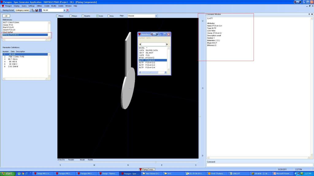

bolt are count two times at orifice plate in new bolting method

there is a problem with ur bolt spec

in ur bolt attributes check the bitems and bit length attributes

The orifice plate is a wafer fitting and should have a connection type beginning with "W"
In your case probably WFBB or WBB (depends on your COCO table.
It does not require a Blrfarray
