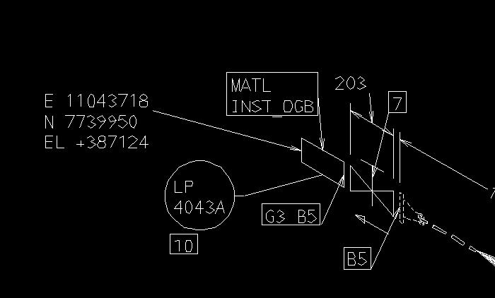

    Hello!!
    I have Flan, Gasket, Bolt.
    I put MTOC and MTOT 'DOTD' in Flange and Gasket.
    But yet show in isometric the bolt.
    Help me!

    when you generate isometrics it will give some isomessages or mess file.
    Please post it to know the routecause,with this info it is difficult to analyse your problem.

    U can add one line 'Bolting OFF' in option file and bolts will not be displayed..

    Select Valve or Flange in Model
    Change Bselector attribute tobe off
    Bselector 'OFF'
