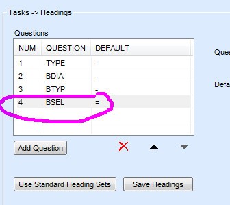

    [QUOTE=me_hungry;99342]Did you set equal sign in pipe component spec?
    [ATTACH=CONFIG]9371[/ATTACH]
    Only one way to set it in Design if you use one bolt spec or maybe have different bolt specS for pipe specS.
    thanks for your reply
    I added BSEL and tested as you showed (I also test with - sign, or B3 as default ...), but It seems BSEL in pipe component spec not work :(
    I am just using one bolt spec for all.

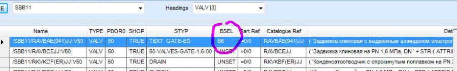

  • Luong Ngoc Quy
    Luong Ngoc Quy over 9 years ago
    I attached image for pipe component spec
