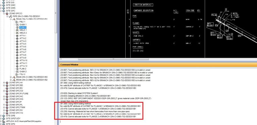

have you set correctly the blrfarray of the catref of the flange?
Usman Shehu Isa
over 8 years ago
No how do I that?
Juan dela cruz
over 8 years ago
No how do I that?
for new bolting method, boltref is set in the catref unlike in Old method that it is set in the spref.
If you're not familiar with new bolting method, kindly search this site as there is a bolting manual that was created by a member in this forum.
