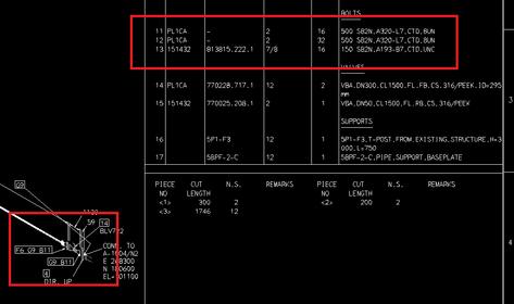

Bolting error

    Check Nstdblength for this bolt size, i thing you are setting standard bolt length from some thing like 150 200 300 400 500.... So any bolt between 400 and 500 will be raised up to 500.
